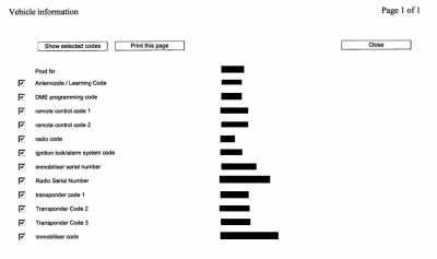

I am thinking of buying an Autologic tier 1 diagnostic/test set.I want the ability to code any modules I may replace and keys , instruments etc etc. They are £8k + tax so not cheep. Has anyone any experience with IPAS codes.
I have spoken to Porsche UK and I know how to get hold of my cars IPAScodes but I know very little about them.
How many codes are there or the car, is it a different code for each control module or just one generic code for my car.

The only three you really need are the Learning Code, the Immobiliser Code, and the DME programming code. With those, you can do all the programming you will ever need. I have the IPAS codes for mine, and have programmer new keys, and updated the DME fuel map without any problem.

Loren, thats why I have posted , I am thinking of getting the above tester. Its a tier 1 diagnostic and will do everything PIWIS or pST2 will do.Thanks for the chart.Where is it from, and what is it. How would I get tha data thats on it?
Richard, when you say you only need 3 codes , will they allow you to fit replacement modules, for eg ABS/PSM, Alarm, Dash/instruments,Tip,air con etc...
For a 9x6, those are the only 3 codes you need, and they are required for programming for the DME and alarm/immobiliser control units. You don't need any security codes to change the cluster, abs/psm, tip, aircon, etc.

on 9x6 you only need the alarm learn code and if coding a remote you need to long number on the label, autologic will code keys
