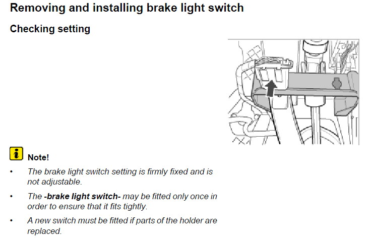

  On 12/26/2010 at 3:09 PM, Loren said:
From the Cayenne Service Manual...
Loren, i took a good look and there were no wires or anything that seemed to be missing. i've replaced these switches before on my old Mercedes so i know what im looking for, my version simply does not have one... with the brake lights still working fine, it validates the brake sensor switch's operation.
please see part no. 5: http://www.autoatlanta.com/porsche-parts/9PA-03-06/604-00.php
But I'm not convinced its this part at fault due to the brakes and the lights working fine...
thanks
  On 12/26/2010 at 4:51 PM, Loren said:
Please check again - my under standing is that they all have this switch.
Are the wires there and the switch missing.
With all due respect Porsche does not a put a diagram in "their" service manual of a part that does not exist.
Perhaps a second opinion from a Porsche shop?
Loren, i didn't state it doesn't exist. All i'm saying is that late 2004 Turbo and onwards do not seem to have this part, but 2003 etc do.
please read:
So your car is really a MY05 and the stop light control is provided by the ABS/PSM system.
I am closing this thread and will answer in the original thread.
