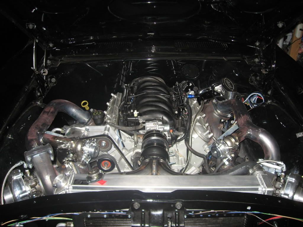

The engine I have is the 305 hp / 330 tq version, which is certainly respectable. Of course, I will want more and there will likely be some kind of turbo configuration in the future. I have a 1969 camaro with a twin turbo LS setup that I built that puts out around 600 hp at the wheels, so now I'm addicted to the power :)

are you putting in a center radiator to improve the cooling, esp if the car is going to be tracked? my guess would be that the v8 will actually be easier to cool properly than the boxster-6. and, all purism notwithstanding, and a possible apology in advance to Loren, how about a pic of your hot '69 Camaro too? Cheers, jl
No plans for a center radiator. The LS motors are actually pretty easy to keep cool, but if I run into issues it will be something to consider. I'll post a couple pics of the camaro when I get a chance.
