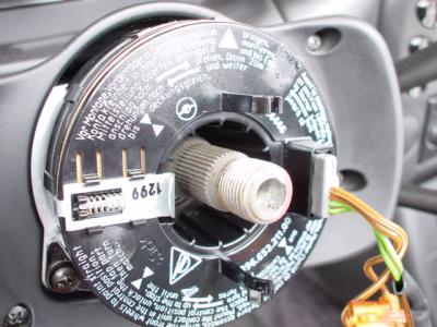

does anyone have a pic of the steering clock spring? Where exactly is it? Do you have to remove the whole steering wheel or just the airbag.

I have to look for an old post somewhere, but the noise you mentioned reminded me of an incorrectly positioned steering column assembly.
If you look at TP's picture, you can see the gray housing that holds the unit in place. This unit can be moved up and down on the shaft.
If you put it too far down on the shaft, the steering wheel column will make a ticking, or grinding noise when turning, because it is hitting the 'clock spring'.
The solution that I am aware of is to move the entire assembly towards you (higher up on the shaft) to allow sufficient clearance underneath it.
Greasing will not solve this problem.
Thanks for the hint. From what I read my noise most likely is the spring. It gets much worse the colder it is which doesn't seem to match up with a shaft problem. If greasing the spring doesn't work I will surely try your suggestion. I'll let you know how it goes.

The clock spring is just a connector to the airbag. The wiring is coiled up (about 6 feet or so) that allows you to rotate the steering wheel from all the way left to all the way right. If you open up the unit, the coil will jump out at you, and putting it back in is a nuisance. More important, you have to find the 'midpoint' again, otherwise you'll either create too much slack, or tension when rotating the steering wheel. To prevent this rotation from occuring, the tensioner spring (silver left in first pic), will keep the coil centered when removed from the steering shaft (The steering wheel pushes against this spring, allowing free rotation of the coil).
Besides, you only have to take this unit on or off, to get to the stalk unit below it. This is the one that may be mounted incorrectly (second pic below). You can move this up and down on the steering column. That's where I think the problem lies.

It was actually very easy. I'm still not 100% sure what was making the noise but I greased everything that looked like it might be rubbing and I tightened everything else and all is good. It hasn't made a single sound. The real test will be in the morning when the car is cold.
Just wanted to let everybody know that the grease/tighten technique might have worked.
After driving for a few days I would say it's 98% fixed. The only time it will make any noise if I'm pulling out of the driveway and let the wheel go after full lock. Even that has been reduced to a softer noise. So not 100%, but free so I think I'm still ahead. I'll try and track down the other 2% if i get a chance.
