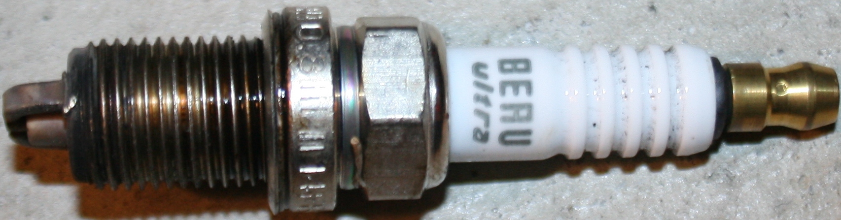

My car recently went through the 30K mile service and I had a few questions I was hoping to get answered. First some history: I have been getting CEL's with codes P0300 and P0306 when the car is at idle shortly after starting the car. I pulled the plug on the No. 6 cylinder and found it was gapped at .4mm so re-gapped it to .8mm. Since then I haven't experienced any further CEL's in the last half-dozen times I've started it. The car now has 33K and is an '04 911TT cab.
I've attached pictures of the No. 6 plug:
The plugs are BERU, however, I've been told Porsche has replaced these with BOSCH. Are BERU plugs still acceptable for Porsche dealerships to use?
Is it normal for a plug to look like this after 2,170 miles?

Porsche uses Borsch and Beru interchangeably. Some folks swear by one or the other - but I have never seen any difference in life or performance.
They look normal to me.

Your plugs look amazing after 30k miles. Mine are more burnt that your after 300miles.
Cool - the plug actually has just over 2k miles in that picture.
