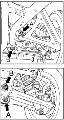

Where are the adjustment points?

For the rear, both lower arms (on one side) have eccentric bolts. If you adjust both, you adjust camber. If you adjust one, you only affect your toe.
For the front, I found eccentric bolts at the upper arm to body connections.
Remember that you always adjust camber first and then toe. Camber change will majorly impact toe while a change in toe will minimally impact camber.
  On 11/23/2010 at 12:08 AM, Loren said:
Front -- A is camber -- B is caster
Rear -- A is camber
awesome Loren - thanks for the clarification...
Rear -- A is camber
