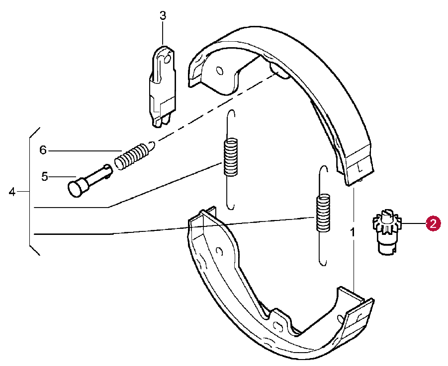

3. Adjust brake shoes (on both wheels). To do this, unscrew the plugs (arrow) and turn the brake disc with the opening towards the adjustment device position. Using a screwdriver, modify the adjustment device until the wheel can no longer be turned. Then unscrew 6 teeth (wheels must be free to turn).

I did exactly what you stated because those were the directuins in the service manual; but, it also turned the axle with each turn, and didn't make a difference.
FYI: I just did the brakes on all for corners and thought that the traveling distance would have gotten shorter- but it was fine to begin with and now only works after depressing the pedal all the way to the floor. I replaced all the rotors, pads, spring kits and bled the brakes and my brakes are working perfectly.
You are turning a star wheel that turns a screw to move the brake shoes closer or moves them further away from the inside of the rear rotor (drum).
You might have to turn quite a bit to get them to cinch down so you can feel them.
