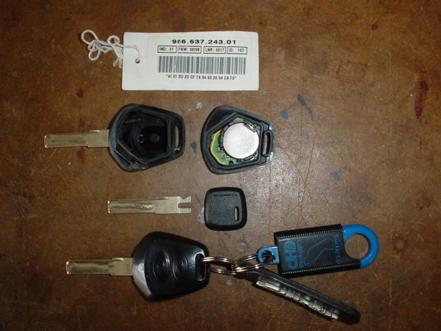

I just participated in a group buy on Rennlist for the new Carrera GT key from Brandywine. Following several recommendations I am trying to swap the components from my '04 C4S key into the new CGT key. Unfortunately I am at a loss concerning the metal "key" part: there seems to be no way to remove it from my old key without breaking it.
I am trying to avoid the time and cost of going all the way to my dealer to have the new key reprogrammed. Apparently this method has worked for many others--is there a difference in MY'04 keys?
I know that I am also supposed to move the small capsule containing signals for the steering wheel lock.
To make matters worse, I now cannot snap my original key shut all the way, even though I replaced all components perfectly!

There is a small catch which clips into a notch on the metal key. You need to pull that back and then the key just pulls out. Just persevere with it - it is terribly easy really when you work out how the key is held in.
And the old key definitely goes back together. Sounds like you might be rushing it a bit :) . Check the PCB module is correctly oriented to sit flat.

Since it's so easy to transfer the internal components (see above) there is no real reason to pay the dealer for programming the CGT key. I now have an extra key head with the internals which could be programmed should I lose one of my 2 other keys.
It doesn't make any sense since the electronics are identical. Perhaps a newer battery makes a difference. My transfer to the CGT case used my spare key, so I attribute the slightly improved range to the fact that my original key was operating with a somewhat weaker battery.
same identical internals??? In that case i'll just do it myself and save the trip to the dealer for programming.. :)
I'm having the same problems getting the old key to snap back into place..
I was able to swap out the 2 internals and got the new cgt key back together in 1 piece..
Any tricks to getting the old key to snap back in flush?
