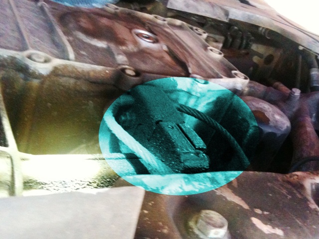

Maurice,
Appreciate the prompt response - I did take it in to my mechanic's today and the car was inspected under the jack.
Attached is the photo with the area marked on the oil leak portion.
Por986,
You may have just answered almost all the questions that I have here. Same experience as yours, car never leaked oil before the AOS replacement.
Note spots (verified by the mechanic to be not large) after long drives (doesn't show up with short ones though).
Same thought process from my mechanic too - that this could be taken care of when the new clutch needs to go in - though it is hard to determine if the leak is cos of the RMS or the IMS (I would presume, once there, both could be replaced).

post-62596-0-58478800-1289600161_thumb.j

Shyster:
A little difficult to tell from that photo where the oil might be coming from.
1) IF it is only your RMS leaking, and it is not a big leak, it's more an annoyance than an emergency and the greatest risk you run is that the clutch disc will become contaminated with oil. Since you already have 102K miles on the original clutch, that would not be a great loss. Just be careful to monitor the clutch disc wear so that you don't run it too long and risk damaging the flywheel if the rivets from the disc start to gouge the flywheel surface.
2) If it is the IMS leaking (and there is no absolute way to tell short of pulling the transmission), then there is the possibility that the sealed IMS bearing has started to fail, and that could certainly lead to catastrophic engine failure.
For some peace of mind, since it just started leaking, you could drain the oil and inspect the oil and the pleats of the oil filter for any metallic bits or plastic bits. The plastic bits would be bits of the seal on the IMS bearing. To do a thorough inspection for any plastic bits, you would have to pull the oil pan and examine it more closely.
