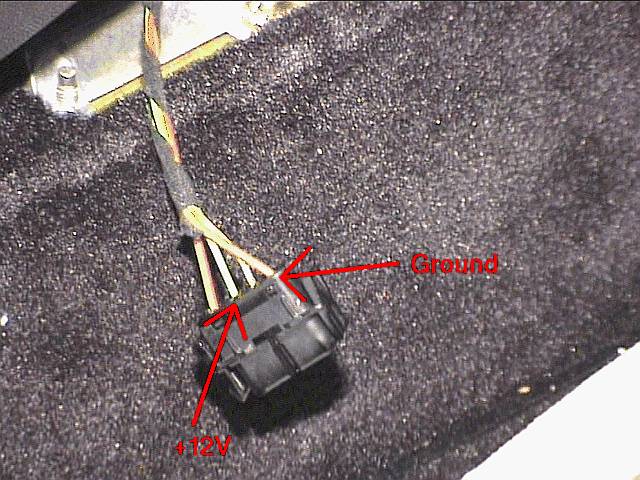

Ummmmmmmmmmm……guys, you do realize that there is an switched power supply for the OEM cell phone (unused on most cars) that is just laying at the bottom of the center console section of the dash (just pop off the passenger side center kick panel, and there it is…) which is perfect for this………
I stand corrected. It is the unused harness for the OEM Cell Phone (not PCM) as JFP in PA suggests. Great Pictures JFP!

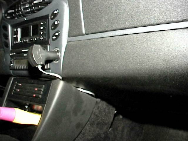

Here is a photo shot of my current setup with the power cord running to the lighter socket.
You can see it is a very short distance to the instrument cluster behind the 4 way. I ordered the needed wiring harness from Escort. Here is a LINK to the harness.

I used the switched cell power and ran harness from Becker to the cell plug (to avoid cutting factory harness). This to tie into the remote mounted in a blank batwing I got from Suncoast for about $7.00. Then ran the wire form the Becker kit up the A-pillar padding to the visor mounted RX-65
There is also an unswitched lead that is handy for powering my hardwired garage door opener to a Targa top switch in the horsecollar.
