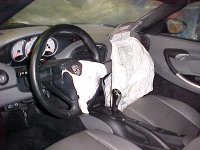

Steering wheel air bag splits. Both the 3 spoke and 4 spoke If you have a vinyl one it is easy to see the pattern, or trace it with your finger pushed against the cover.
It is bolted in place. It is not on a hinged like the passenger side front air bag.
Pic from Tony.
I would not put anything on an airbag cover. the speed that it moves will fling anything off that is not properly fastened, like the factory set up. I am sure they set off a lot of bags to make sure the crest did not come off.
