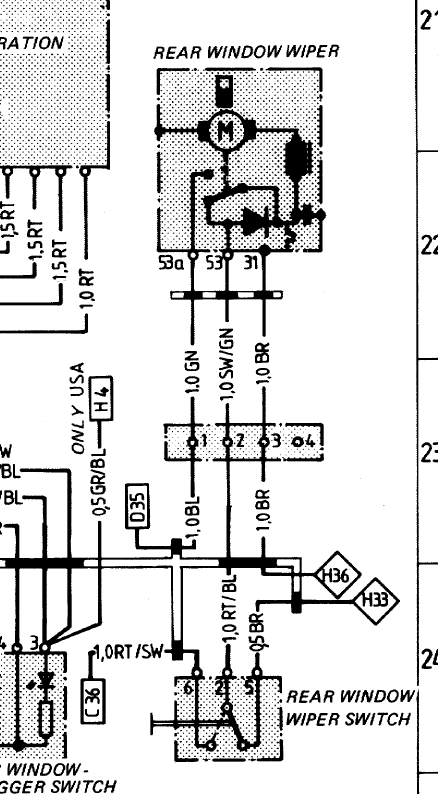

Perhaps this will help.
It appears that the wiring follows the rear window defogger wiring.

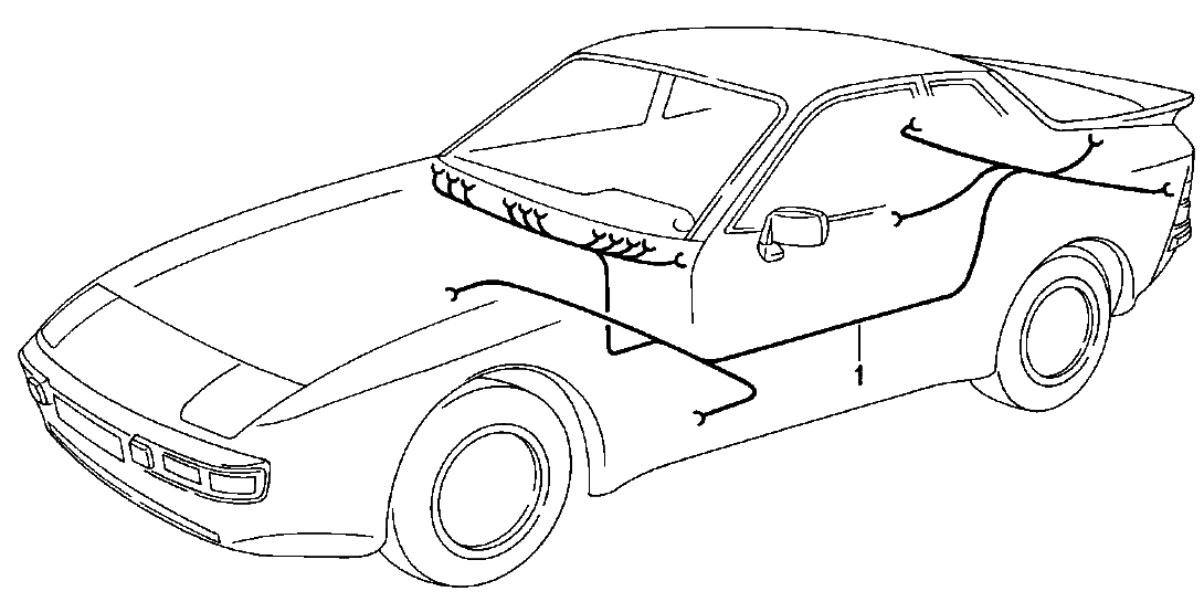

I am trying to trace backwards from the wiper motor, where does the wires join from the motor wire harness 99461206501?
does this run along the side of the rear window?
where does that wire come from?
along the roof or under the seat? from the switch
any pics will help
Roger
This is the only harness that goes from rear to front (or visa versa).
