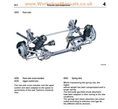

Here is a picture of the strut towers. It looks
like three nuts hold the strut tower to the frame.
The tower are just a little behind the wheels.
Maybe you do get to these from the back seat. I
do not know.
You could try calling tire rack. Here is the pss10
for 997 cars.
http://www.tirerack....0+Coil-Over+Kit
