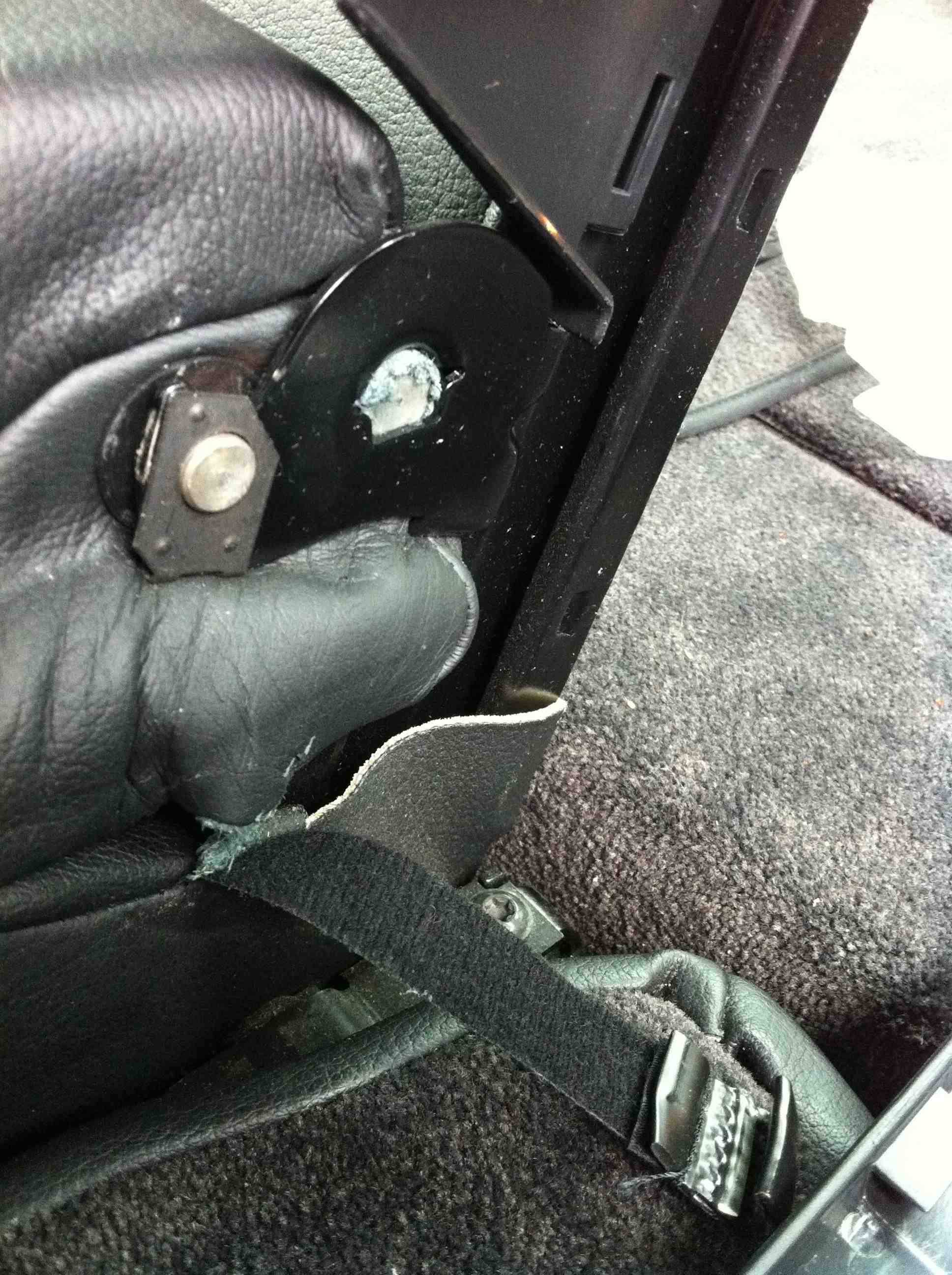

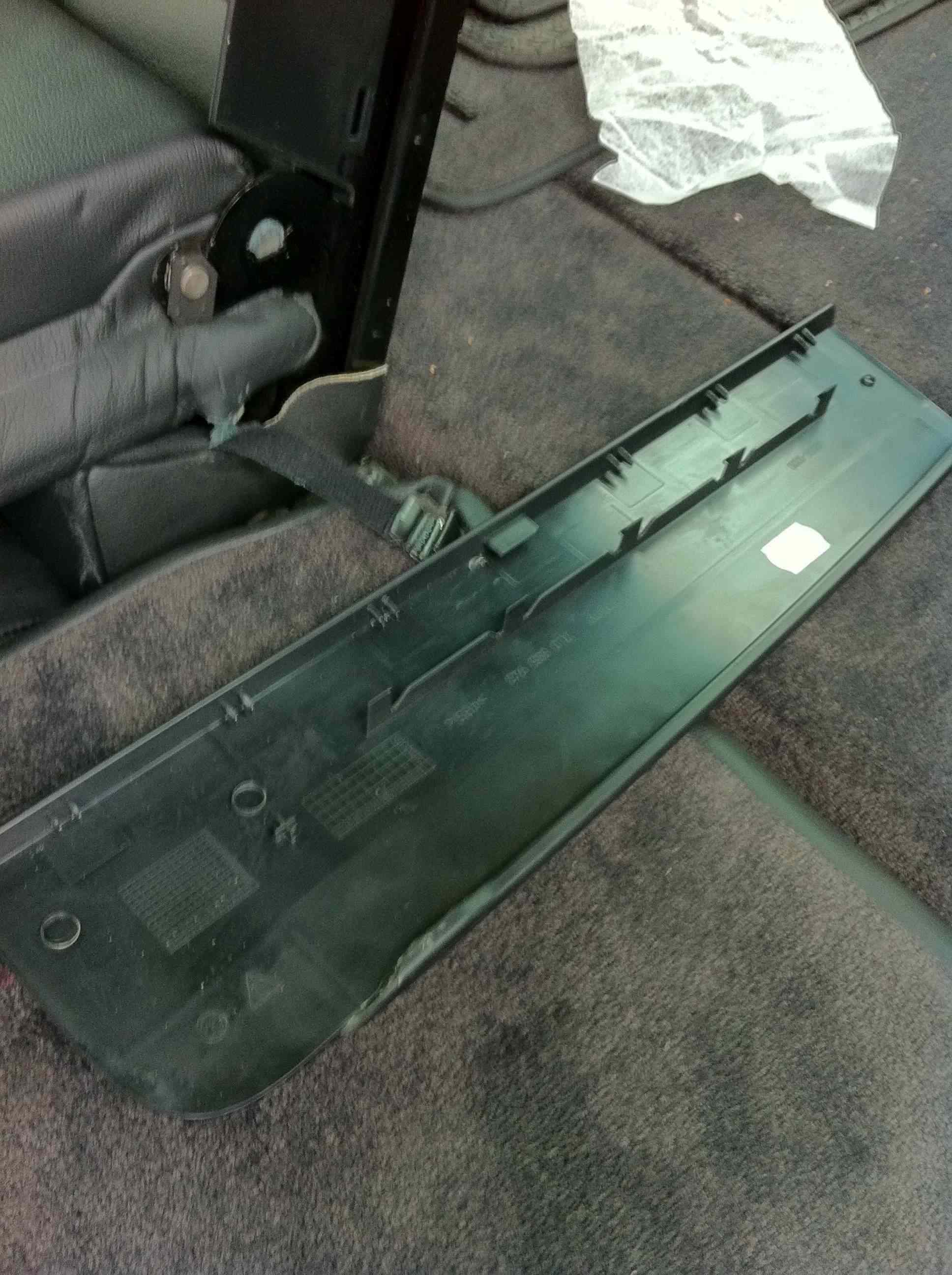

Removed the Armrest yesterday. Took about 10 minutes, no tools needed. Here are a few pictures, maybe they will help someone else.
The cover peals back pretty easy, its tough down around the hinge, but it will pop loose.
The clip in picture 2 pops off with your fingers.
The last picture in the right hinge, tilt the console up at about 45 degrees and you can actually look down and see the pin, just angle it up and pull it our of the hole in the hinge.
Hope this helps.
