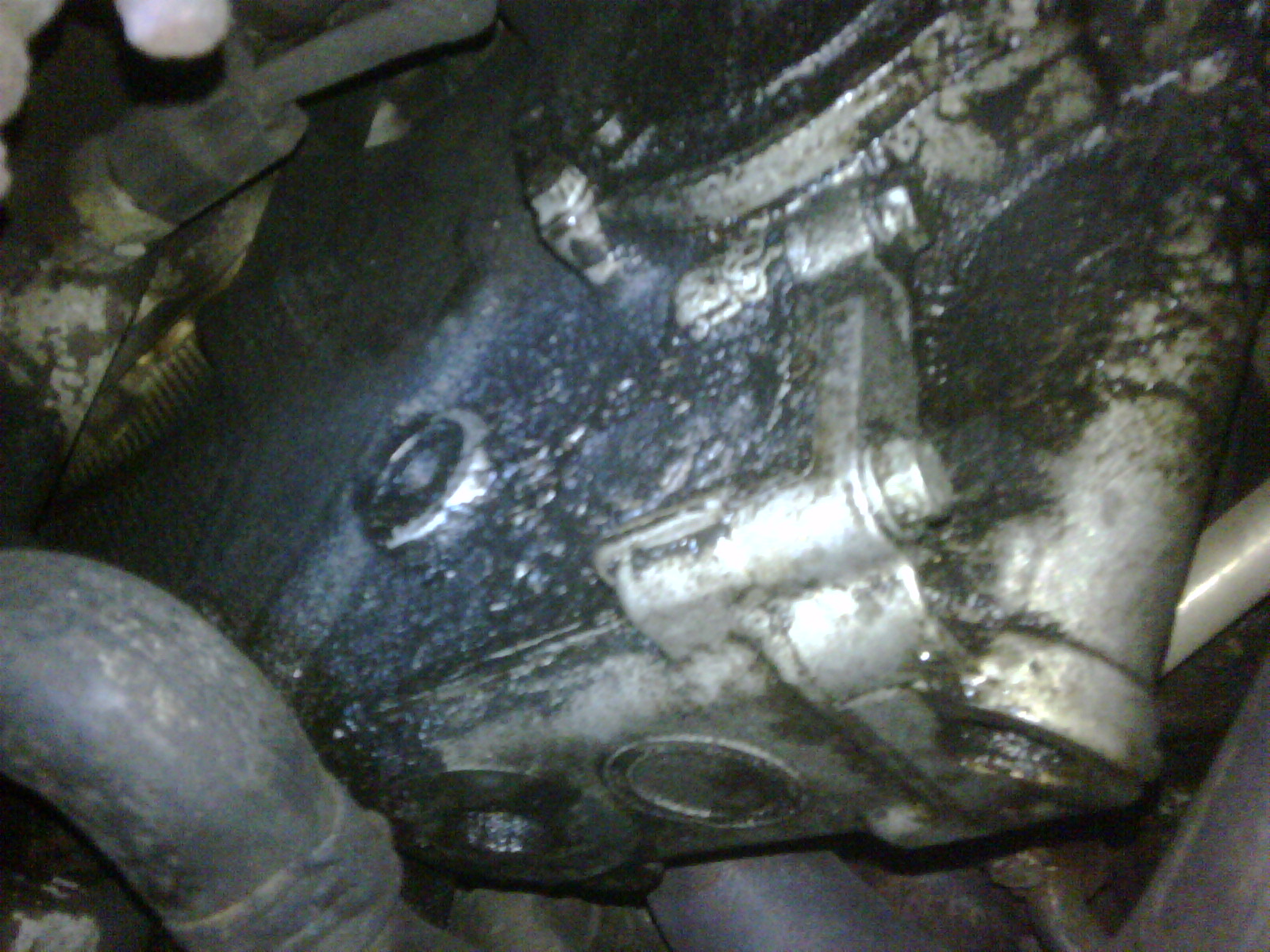

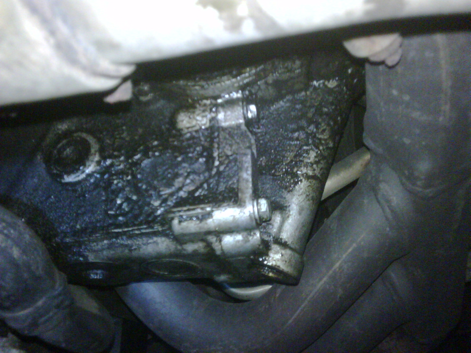

Absolutely right....OK...here are a couple of pictures. Hope they help. Oh, and its not the motor mount, they look fine and dry.
Again, its a part of the actual engine, that is its cast aluminum.

Its hard to tell because as Loren said the accumulation of dirt and oil makes it hard to locate the source of the leak. However, the areas that are the cleanest will lead you towards the source of the leak. The detergent properties of the oil tend to wash away the dirt in the most flooded area. From the pictures you provided I would take a look at the oil pump cover but it could be coming from higher up such as a cam plug or valve cover. You won't know until you clean the engine and get up in there with a good light. Let us know what you find.
Cheers, Tom

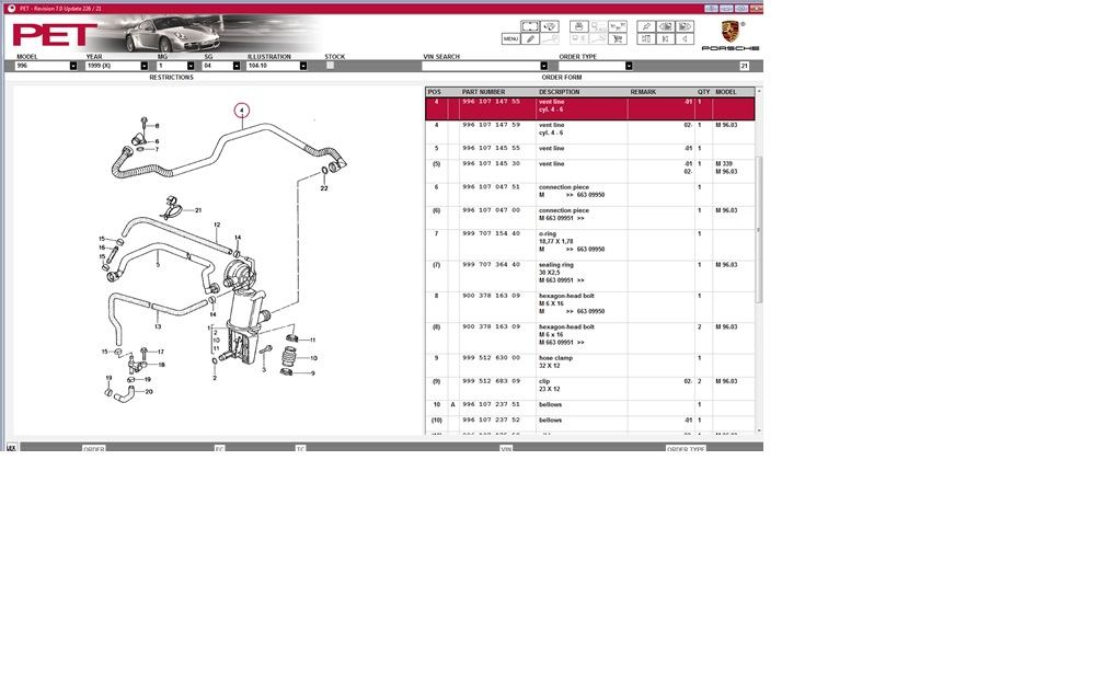

Very true, the AOS is ondriver side front, but one of the lines (#4) from the AOS runs to head 4-6 by the A/C compressor and goes into a port with a vent (#6). Sometimes when the AOS goes bad, oil is blown from that vent. If you look around to the right side of the A/C compressor, you will see the vent post-26548-080479200 1286371761_thumb.jp
