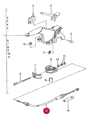

do you think i just broke one of the cables then? the brake still holds, the handle just has to go up a lot futher then it use to.
You are going to need to investigate further.
The handbrake handle inside the car has two cables that connect to it to a turnbuckle.
One of these may be broken or not connected.

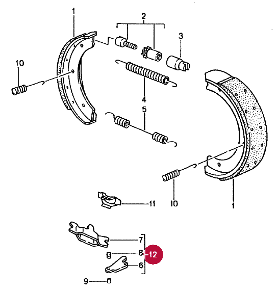

If all is okay there then you need to check inside the rear rotors for parking brake shoes (where the other end of the cable attached to.
