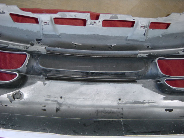

I have a 99 911 with a 6 speed Aero nose on a Tiptronic car. Does anyone know of a body shop in Dallas Texas that can remove the center portion of the air intake so I can cool the center radiator?
Thanks for any advice.

It is not hard to remove - you just need to cut the RTV that holds the plug in place.
Best done with the bumper off (a 15 minute job).
