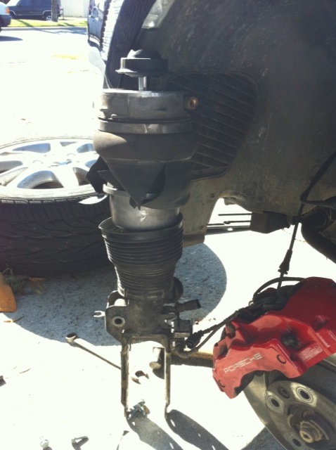

this same thing happened to me 4months ago 04TT. Drivers side blew. drove it home Carona to Long Beach 40miles, A little bouncy but it had enough support from the pass side to support it. the air pump shut off after a few mins. That sucks others are having the same issue. And see the second pic, I did not cut that metal casing. It blew and just with the air pressure, it totally shredded it in half like a tin can

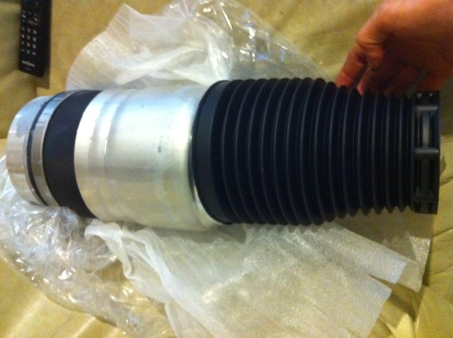

I'll try to do my best with the photos i have. I do not have any more with the strut apart. Sorry if I forget a step but i'll try to remember as much as i can. It is the same for either passenger or drivers side air bags. I'll try to do my best not to make it seem too confusing.

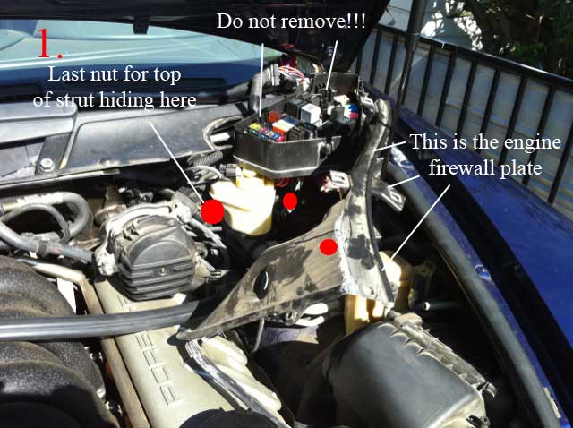

5. In the engine bay, In photo labeled 1 remove the plastic side covers and the other plastic covering the air pumps.
6. DO NOT do what i did and take apart that fuse box and everything there looking for the bolt . lol. its not there. instead, there should be about three small screws holding the first layer firewall, about two feet long, in front of the brake booster. the screws are behind the fiberglass heat shield. Also, remove any connectors attached to that two foot section of firewall. This is the first firewall closest to the engine.
7. you should then see the last nut underneath the brake booster. in photo 1, unbolt all three bolts seen in the approximate location marked in red dots.
8. lower the jack placed in step 2 to slowly lower the strut. swing out the upper control arm twards the rear of the car so it looks like photo 4.
9. theres three more small nuts holding the top of the aluminum casing/upper control arm to the top of the strut. The strut should come out at this point.

12. in Photo 6, slide the new air bags over the strut and one person needs to hold the upper portion of the air bag up while another person slides just the bottom portion of the metal down into the corrugated bellows. the upper portion needs to be as high as possible. Stretch out the Air bags as much as u can. You really need two people for this, I tried to do it myself and it would not go in no matter how hard I tried to force it in. Make sure the air bag snaps in and touches the bottom strut ring.
