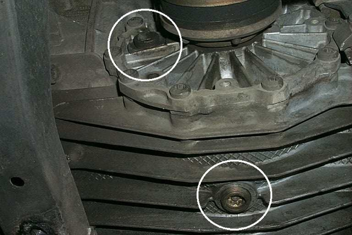

Fill is on the left side, up near the axle; the circles show the fill and drain:
Edited by JFP in PA
The fill plug isn't in that location on the 6-speed transmission (that pic is a 5-speed).

The fill plug is on the left side 3/4 of the way back.. It uses a 10mm internal (allen wrench) hex. Mine was buggered out when I got to it and not I have to replace both the drain and fill to make it right. Each night when I go to bed I say a small prayer the lord of vice, my 25 year old vice grip pliers. They allowed me to remove the two plugs when I was sure I was going to have to drill them out and retap to change gear oil.
