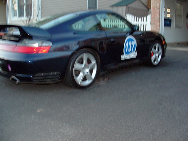

I think my deck lid fan is shorted out, any way to test it? I put an aero wing on car, I think it let a small amt of rain get on the fan, doesn't that happen with a stock lid anyway?
