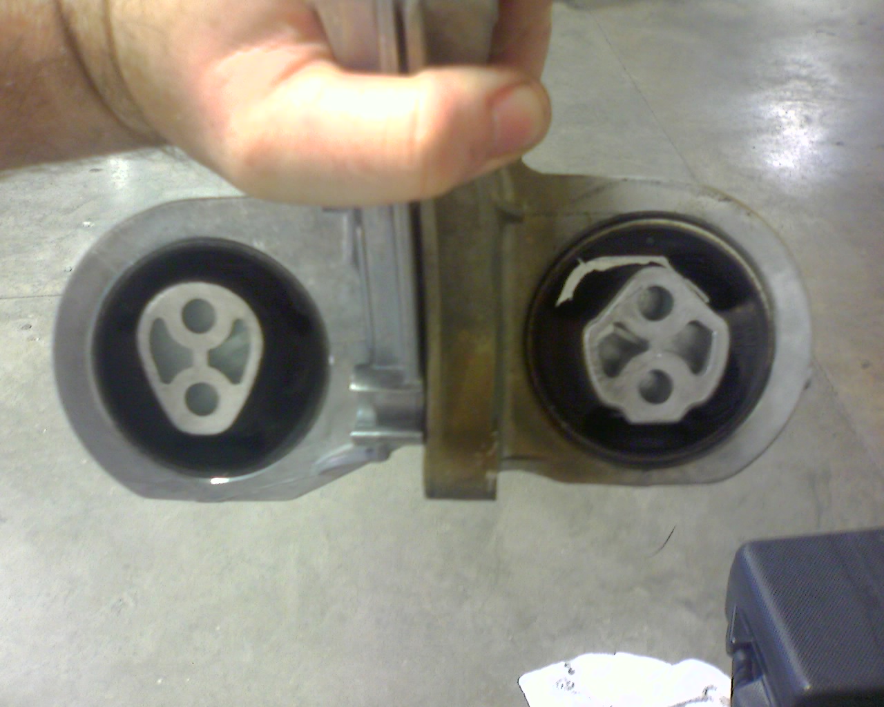

Mine was... notchy going into first, and I would sometimes grind the 2/3 shift. Part of it was cured my changing to royal purple gear oil, but as soon as I dropped the plastic cover I could see the mount was worn. I believe the 987 part supersedes the 986 part. If you take a look at the pictures I posted above There is a difference. The mount "wears" with the weight of the engine siting on in the donut and causing the bottom to compress and the top to tear. Mine shifts like new after the mount change and the gear oil change.
