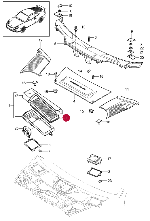

Dear All
I was wondering if I can replace the air filter by myself for my GT3 RS coz right now there are smell coming out when I turn on the air con. I have try the method that is turn on the heat for 15 mins but cant resolve the problem.

Hi
Thank you so much for the diagram whilst may I ask if I need to take out all the panels shown in the diagram before I can replace the pollen filter? BTW, Is that the one and only filter for the air circulation system?
Have a nice day!
Your pollen filter is under the front hood and removing the plastic panel.
Very east to replace - part number 997.571.219.01
