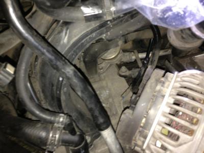

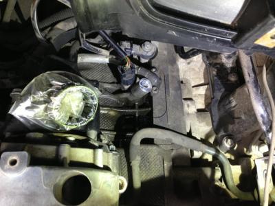

I have a 2007 997.1 Tip. Started to replace AOS but can't seem to locate it. I've remove both AC unit and Alternator but don't see it. where else to look? Thanks.
