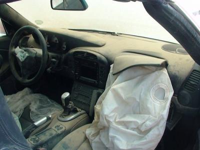

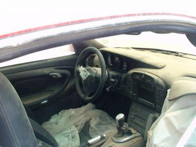

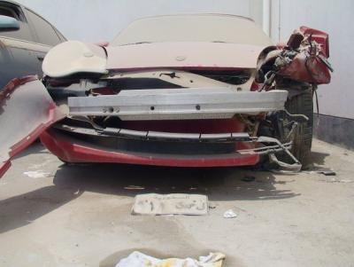

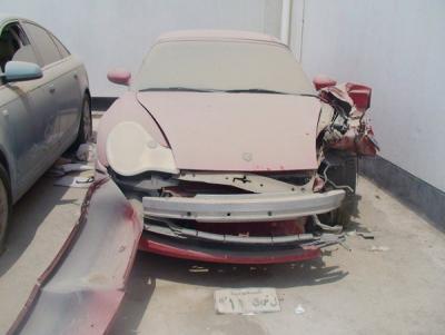

I attached some pictures, and was wondering if i could get some help estimating what parts i need and how much it would cost me.

It´s very difficult to estimate the damage by the photos.
Remember the Porsche parts are very expensive (just Porsche makes them), especially for the bodywork. 15.000 $ is nothing in your project, plus the labor. Apart from sheetmetal parts, there are numerous hoses and other bits and pieces you will need, and they are not cheap.

I need to know what parts are obviously needed. is there a radiator behind the bumper on the left ?
Look at the numbers involved. The entire front-end will require reconditioning. New sheet metal. New fender. (I'm not sure but is that part of the frame which surrounds the trunk/boot?) That needs to be replaced/repaired too. A/C fans are probably damaged. There is potential damage to the brake system (sitting in the trunk). The car probably needs a new paint job from having that much dirt sitting on it plus to match all the new parts. The interior needs a serious amount of reconditioning and new airbags. New set of tires. Not to mention the work to recondition an engine that hasn't been run for 3 years. (You should NOT start the engine until you've had a chance to flush the oil and fuel system, and replace the cooling system's radiator.) Front-end suspension is probably in need of replacement as well.
Let's say you have $20,000 in repair work. Are you going to buy this car from the guy for $1,000 or $2,000? Even after spending $15-20k in repairs the car probably won't drive right anyway. If he wants $10,000 or even $5,000 you're close to $25k-$30k!
Why spend all that money and time when you can save a little more and buy one undamaged for $35,000?

Wow - walk away :) Looks like the frame is bent, plus I imagine the impact caught the front wheel, so brakes, axel, tires, bent wheel, plus cooling system, all that body work..... yuck

If you got the car free it would still cost massive amounts to repair and I always find that vehicles that have been in a major collision such as this one will have endless creaks and rattles if you do get them back on the road. Whatever you think think it will cost to repair- double it. It's deployed the air bag and has been sitting open and exposed to the element so it will have hidden faults besides the body damage. Unless you have deep pocket and a great sense of humor I would stay far away from such a car.

Seems clear from the pitcures that we are looking at a parts car here...bad damage and exposure to the elements. If you want to do a good deed for Porsches everywhere, dismantle it and use what is still usable to extend the life of others...

if frame is not bent too much (local body shop will get it for you) and suspension/steering is intact the rest is not that problematic. look at the list of main body parts so call it $5k for body parts repair, you will need PIWIS for airbag repairs (they will be around $2k with all bits and pieces), headlight, pipes, radiator, you can get from e-bay, dismantlers, call it another $2k. worse case you can selll it for parts and get you $5k back

Rammi the car has a saudi license plate, and looks like it's been sitting in the dessert for a while, i can't see how a car with Saudi license plate could stay in lebanon for 3 years without moving, the lebanese customs rules are that you have to take the car out of the country every 6 months. and the car can stay a maximum of 2 years then it has to have it's Trip ticket renewed.
