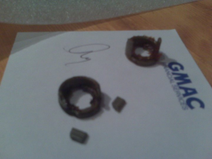

My P car has the same year and model as yours. Same problem appeared as few months back just like what you have described
Remote fob died and no resistance on door lock. Search thru. internet, no solution found.
So I took the door panel off, removed the handle , disassembled the lock mechanism, and found a broken part . Spend $35 on ebay with a used lock and replaced that single part.
Here is what it looks like.

You have to remove the inner door panel first. Steps includes removing several screws that hold the handle, pile out the a few plastic one that goes around the door.
Then, disconnect the door cable and side airbag connector. Once you take the panel off, you can get reach to 2 nuts that hold the door handles. You will then be able to judge why the door mechism is working or not. In my case, I turn the key, but the lever was not moving. Removed the 2 nuts and take the door lock assembly out. The picture was after disassembling the door lock. It took me about 5-6 hours to do that, on and off. If I do that again, my guess would be about 2hours max.
