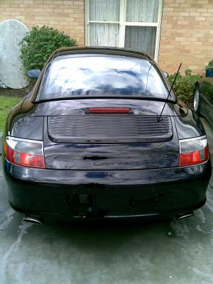

Hi Guys, Im in a bit of a jam and need some help.We recenlty had some bad weather and hail and my rear engine lid had some miner damage (hail dints). Well I took of the whole lid of and took it to my body repairer and he has just told me in order to do a good spray job I need to remove the 'electric spoiler'. Guys some help would be apprecated. How do I remove the electric spoiler? Even a link to some photos would be great. Can it be that hard? Thanks all.
post-33358-034446000 1282020254_thumb.jp
Raise the spoiler. On the back edge of the spoiler you will see two plastic plugs. Take these out, and there are hex-head (allen) screws behind. Loosen these by 2-3 turns each, and the spoiler lid will lift off.

Thank you Richard I appreciate your time. Ill try it tomorrow.
Richard I just want to say thank you again. I followed your photo (mine has 4 caps) and diagram and dismantelled it quite easily. Its now at the painters. Your a champ. Take care. :thankyou: :renntech:
