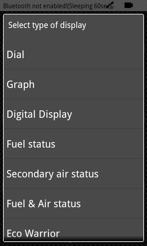

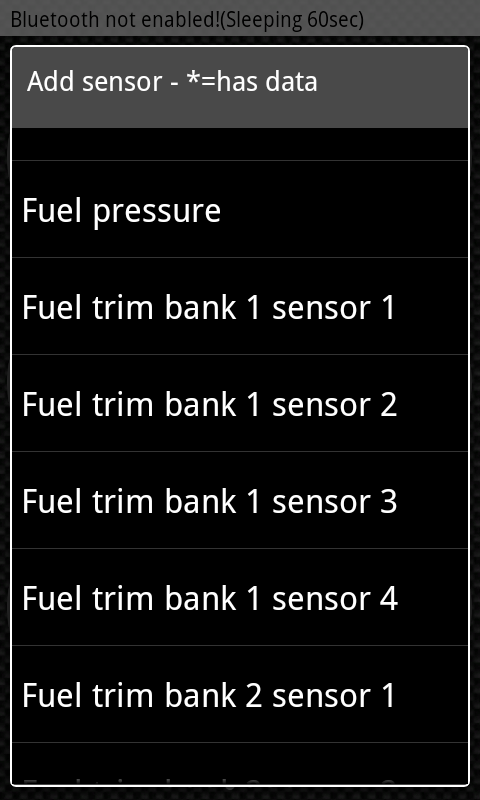

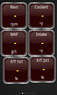

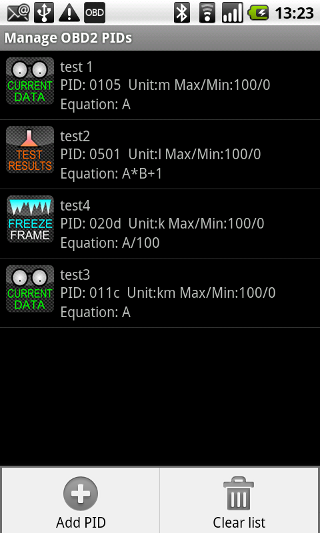

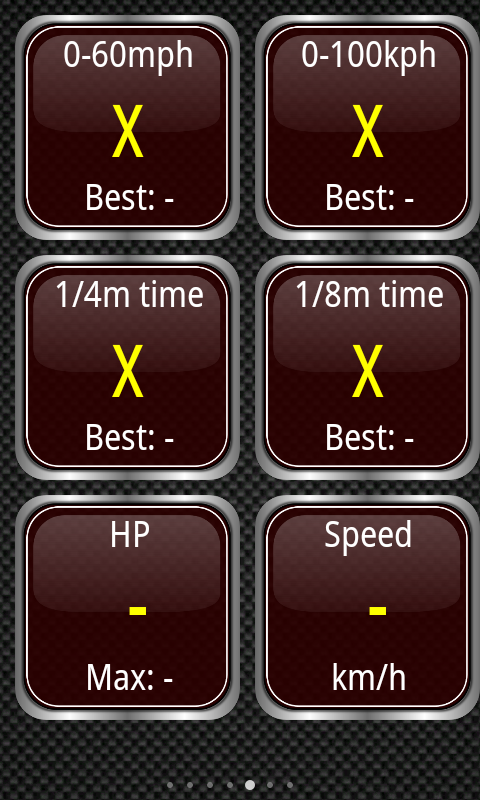

Here are a few screen shots some are pages (with readouts) that I created and others are from the authors website.

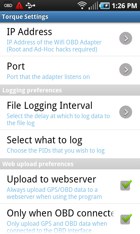

So far I am very impressed. I have not tried the website interface yet - but it can log all of your data (realtime) to a special website that you can only login to with your unique key.
