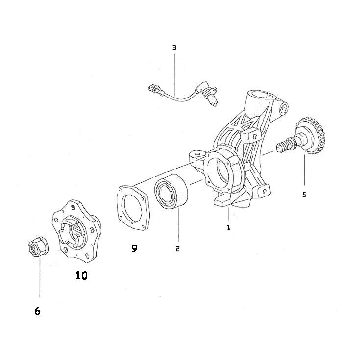

See the drawing. For some reason the drawing does not show the dust shield that is also present.
Once the nut (6) is removed then you can pull out the tension bolt (5). The wheel hub (10) is a press fit in the bearing (2). It needs to be pressed or extracted out of the inner race of the bearing. There are 4 bolts not shown that hold the cover (9) in place. After removing the bolts and the cover you should see the bearing (2). You then use the extractor to pull the bearing out of the wheel carrier (1).
