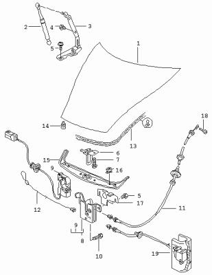

My guess would be wiring to the radiator fan or the windshield washer hose or the main release cable (inside the shielded cable).
Item 12 is the emergency release - item 11 is the normal release cable.
Thx Loren...
I suspect that number 11 in the diagram is the main cable release because you can feel movement when someone inside the car lifts the trunk release lever.
I'll find number 12 release in the diagram when I pull the headlamp assy out tomorrow and re-route that puppy to the front tow hook port...great idea...
