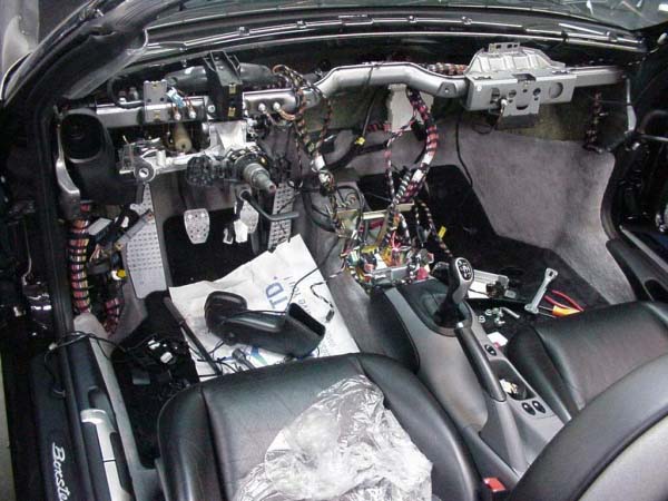

This is Tool Pants pic from a Boxster but a Carrera has virtually the same dash.

There are several 13 mm nuts under the dash that bolt it to the chassis.

Yes, but where are they? And, it doesn't seem like I'm that far as all of the bottom is already loose and now its only the top. I just need to locate the rest of the screws and then its out.
