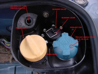

Yes, the coolant cap is easy to find and is located next to the oil fill cap. Actually you have to look under the trunk carpet if you suspect a leak in the water reservoir.

Gulfstorm:
Here is a photo of the top of the coolant tank, showing the various components (clcik on the photo to enlarge):
