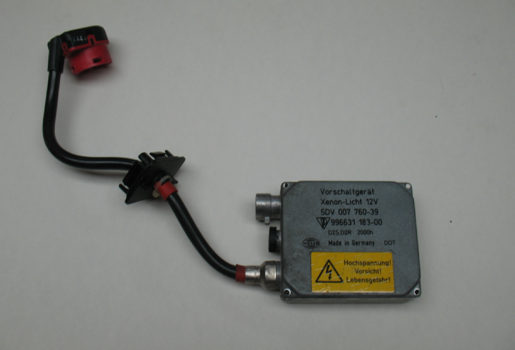

My wife and I went to the cost of Maine and did 2047 kilometers with the TT. But this trip included some issues. Some that I was aware of before departure and some completely new.

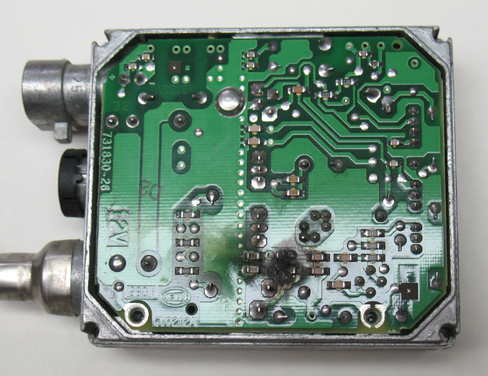

First, in the middle of the trip my left front headlight (xenon) stop working. I switch the light bulb with the right hand one , no fix. And last night I switch the litronic control unit and that was at fault. $641.00 at Pelican and I got a used one (tight budget) on Ebay for $138.00 shipped. I remove the bottom cover of this unit and found the circuit board with a burnt spot. part # 996-631-183-00

The Litronic Control Unit should not have burnt out, but you did very well diagnosing it and getting one on eBay for $138.
