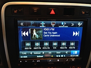

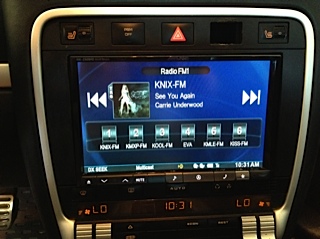

So I had the Kenwood in for 3 years, it was ok. The head unit itself had a lot of glitches in my opinion for a "Flagship" model. It was slow, very slow and not that responsive to touch were my major complaints. I have since just updated to the new Alpine INE-Z928HD. Since I use the Nav-tv Most HUR I have only Kenwood and Alpine to choose from. Kenwood made this real easy, no major improvements same slow interface. Well I absolutely love this Alpine, very fast and sensitive to touch. The 8" screen fills in the dash super nice. I really love the HD radio incorporated into it, it displays cover art!!!!.

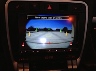

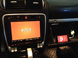

I added some extras this time, I did keep my SiriusXm (love it for my Fox news fix on the way to work) and the old 30pin iPod adapter. I added reverse cam and a HMDMI to composite converter. This converter is great, it is powered by USB and it will convert HDMI signal to composite. I use it connect my iPhone 5 and use the mirror display. I used it last weekend to keep kids entertained with Netflix. I just use iPod adapter as video hardrive, I have an old 120GB ipod that I have tons of movies loaded on now for long trips.

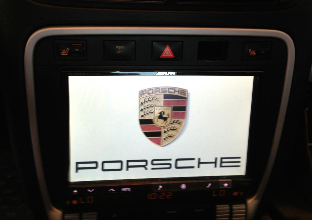

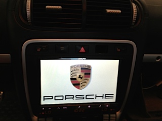

The hardest part of install (most frustrating) was getting the boot screen converted to Porsche logo. The poopoo heads at Alpine will not release how to do it. Unlike Kenwood where there is forum for hack and mods there is no forum for Alpine. I am still shocked by this. Alpine wants only "Flagship Installers" to do this mod, called one up and they want to charge $100. In short, I have acquired instructions from a friend of friends kid who works at a installer. What really ticks me off is that it took less than 3 min to do. I have included (if possible) a formatted Porsche logo, the one I am using.
Instructions and pics below, enjoy:
Alpine Boot Screen instructions (as usual, attempt at your own risk)
-Picture: Save as BMP, 24bit , 800x480 (24bit = 8bit x 3 color channels)
Save onto fresh formatted USB drive and connect to USB port of radio
-Press and hold the "Band" soft key on radio screen for 2+ sec
-Press the dual screen soft key once (lower right)
-Press telephone hardkey once
-Press volume down button
Please Wait will appear and it will automatically reboot with Porsche Logo
I have screen shots sent to me of the page from actual instruction manual, but I don't want to get sued for copyright etc etc.

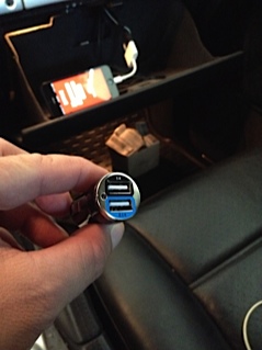

Since the HDMI converter is run via USB, I got a generic 12v accessory female reciever and wired to the acc switch, so it is only powered when car is on. Then installed a dual USB charger and connect the iPhone and HDMI cords to this. So this will autmatically turn on when car is on and shut off when car is off. This will also charge the iPhone too.

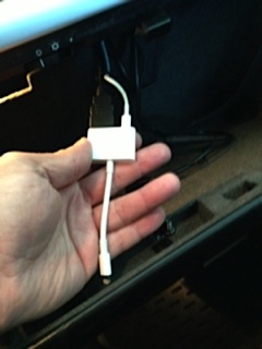

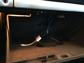

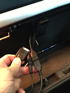

Glovebox connections: HDMI cord/Lightning cord to adapter, Alpine 30 pin ipod cord with USB,,,,, no dual USB on this unit.
post-45807-0-02166100-1379530274.jpegpost-45807-0-46815400-1379530293.jpeg post-45807-0-67214600-1379531394.jpegpost-45807-0-09519800-1379531431.jpeg

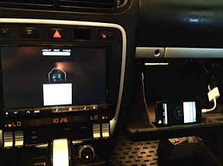

Mirror display
HD Radio with Cover art and TV button for iPhone
Rearview Camera, comes automatically when you put into reverse

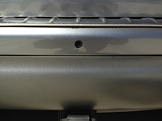

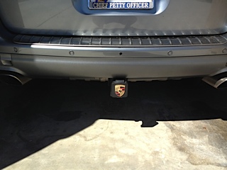

I used same face plate, used my Dremel and a file. I was torn between bumper and rear wing, as I was trying for a discreet look. Bumper came out fairly well and I can plug hole with "Bumper Plugs" if need be. I went with the actual Alpine camera for plug and play purposes. It was real easy. I also chose bumper because of easier wiring. It was straight forward, pull bumper off, drill hole after marking of course and running wires to deck. More patience than anything, no hiccups at all.

Some follow-ups about the camera: how do you route wiring from the bumper to the front? Did you hide it under the floor carpet? And how do switch wires from the inside to the bumper - are there any pre-existing holes that you are using or did you had to drill into the floor?
thanks!
I used a step drill bit to make a hole dead center. I routed the cables along passenger side under carpet/door sills. Once bumper is off you have a lot of room to route wires inside. I love Navi and use quite a bit. It works seamlessly with iPhone, you can also have accounts so it will change from me to my wifes settings with a press of a button.
