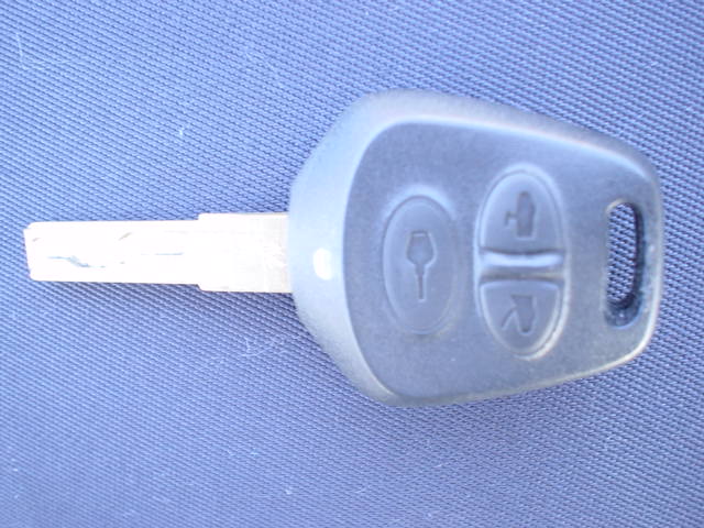

Stephan, what type of key remote are you trying to get? A US remote has a different radio frequency than other countries. Also, the US 996 cab remote does not have the extra button for the top. Jeff
Hi Jeff,
no button for the top??
That means, the USA 996 Cab Top isn't remote controlled??
I hear that for the first time, because here in germany there is a remote control for the top standard since 1997.
Sven
I am a Boxster guy, so the 996 people can correct me.
The 996 came to the US as a model year 1999. There was just one button on the remote for the door locks/alarm. In 2001 Porsche added a second button for the front trunk.
The only 3 button 996 remote I have seen in person is Jay's 2002 996 turbo Ruf. I played with the third button and made the top go up and down with the button on the remote. A US car does not have this feature on the remote. But on a US car we can open and close the top with the key in the door lock.

hmm, I have the 3 button key for my 996 MY2001 cab. It works perfect and I still enjoy seeing peoples faces when they look at the car and I without they seeing me pressing the cab top open/close. :eek:

4) Lastly US 996 only has two button key fob as confirmed, while RoW cars have three buttons one for the Top? Since remote codes are tied the VIN no, Porsche only has remote codes for the two button fob for my car. But I am wondering if there is different mechanism for RoW cars, or if a US car can be programed to use a 3 button remote, (w/ USA frequency of course)? Dealer cannot tell me anything about this.

Also do you know if the three button key can be programed to operate the top of a USA car as it does on the RoW 996 models? Or ... need I say is the REMOTETOP 996 the only option?

Hello Jas,
No problem. I know sometimes it is really frustrating with the car manufacturers. So many things they just don't offer (like an Ipod interface for 997 for example) so aftermarket companies have to figure it out. I didn't want to make it sound like you are being cheap, but it is true, we spent a lot of time figuring the 996 and 997 out as much as possible. The remote is a country specific issue. In the US the remote system runs on 315 MHz, whereas the rest of the world uses 433 MHz. Needless to say that the remotes are not compatible and Porsche for whatever crazy reason does not offer a 3 button version for the US market (they told us it is for "liability" reasons).
Well.. you guessed right. As of right now apart from using a remotetop 996 chip there is no other way we know of to operate the roof remotely. This was originally the reason why we set out to develop this chip. Being from Germany myself
I was spoiled and used to the 3 button remote. Faced with the blunt response from Porsche North America: "No, we don't offer that", combined with the windows and one touch issue and no solutions available on the market, we just had to do it ourselves.
Yes, if I was you, I would just get the smarttop/remotetop and be happy with the added features. Compared to the price of your car itself, the modules' prices should be in the range of "pocket change" :-)
