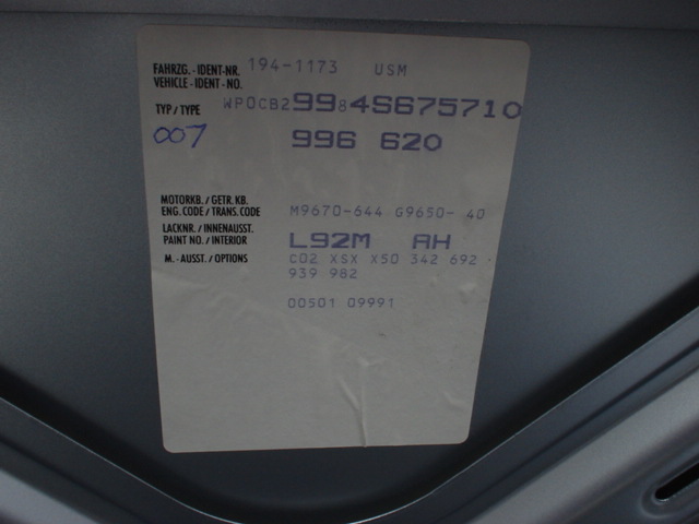

One other thing is to put your fingers in the rear bumper slates and check the intercoolers. I know it might look funny or unconventional, to say the least. The GT-2 and X-50 had upgraded intercoolers that have pronounced ridges on them, if compared to the regular turbo, which has a much smoother surface. A good idea might be to, first, find a regular turbo and than an X-50 to compare.
I don't believe there are any visual distinctions between x50 and non x50 cars. As far as I know the only ways to tell are the option sticker as shown above, the larger intercooler fins, and the higher boost.
