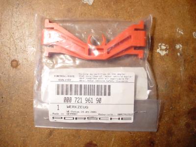

You remove the center console, put the transmission in neutral, then snap the red plastic tool onto the shift. If the cables are not adjusted properly then the tool will not snap on. In that case you disconnect the cables, snap the tool on, then reattach the cables. Once you remove the console you will see how the cables can be disconnected by pushing on a spring loaded keeper and lifting the cable up. Somewhere on this board are B&M instruction and they explain how to remove the cables.
I have used the tool on about a dozen Boxsters and 996s, prior to a B&M install. I make sure the cables are adjusted properly before I put in the B&M. I have never seen a car where they were not adjusted properly. I doubt if it is an issue with your car unless someone has been playing around with the cables, but you did ask how to adjust the shift.

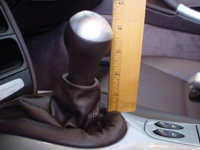

now being happy with the lack of 'notchiness' I set about reducing the throw of the gear stick. After sliding the gear knob on and off a few times to review how it sits on the shaft I decided on aprox. a 1.25" reduction.
I cut away aprox. 1.25" from the top of the shaft with an angle grinder and trimmed it to shape with a dremmel grinder disc. I then carefully reduced the girth of the base of the shaft also by about 1.25" in length to replicate the flat shape of the upper half on the shaft. (gear knob stops sliding down the shaft when if becomes round if you dont, so it would be pointless reducing the length)
put it all back together, slid the gear knob back down to its now 1.25" shorter base and took her for a test drive :ermmm:
Absolutely superb! nice short shift, nice and tight due to the ally bushes and allen bolt adjustment on the B+M bushes, and not one notchy feel in any gear! :D
I am so so chuffed with myself! the car is back in my good books and its a pleasure to drive it once again :D :D :D

What Perry did is exactly what Porsche did for the 2004 986 special edition. The height of the metal shift lever was reduced by about 1" so that the top of the shift knob is also lower than a normal 986/996. This is one way to reduce the shift throws, unlike how it is done with a B&M style short shift.
If you did not want to take a hacksaw and grinder to your existing shift lever then you could always put in the shift tower used on the special edition.

A couple of questions:
Is the orange tool the one for a 97 Boxster 2.5 and also a 97 (presume 98 model year) 996 3.4?
What is the part number please?
Thanks a lot.
PS Very useful thread in conjunction with the short shifter one currently running; my Boxster shift is very stiff laterally even after greasing so I'm thinking of replacing it with a short shift one.

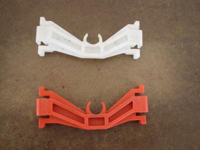

The part number for the orange tool is shown in post #4. I have also seen a white version. Both are the same except for the color.
They work on all 986/996 with the original shift lever.
