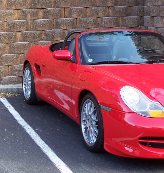

i disagree; i think you can get away with using these wheels, but you are REALLY pushing the threshold of the wheel well. offset of 42 will rub a 275 when you hit bumps. you MAY be able to use the 40 offset wheels with a 265, but they will be RIGHT at the outside of the quarter panels. spacers won't help; your problem is the reverse (you need material removed, not added between the hub and wheel).
attached pic shows a 275 on a 44 offset wheel. your 40 offset would stick OUT 4mm more than this.
