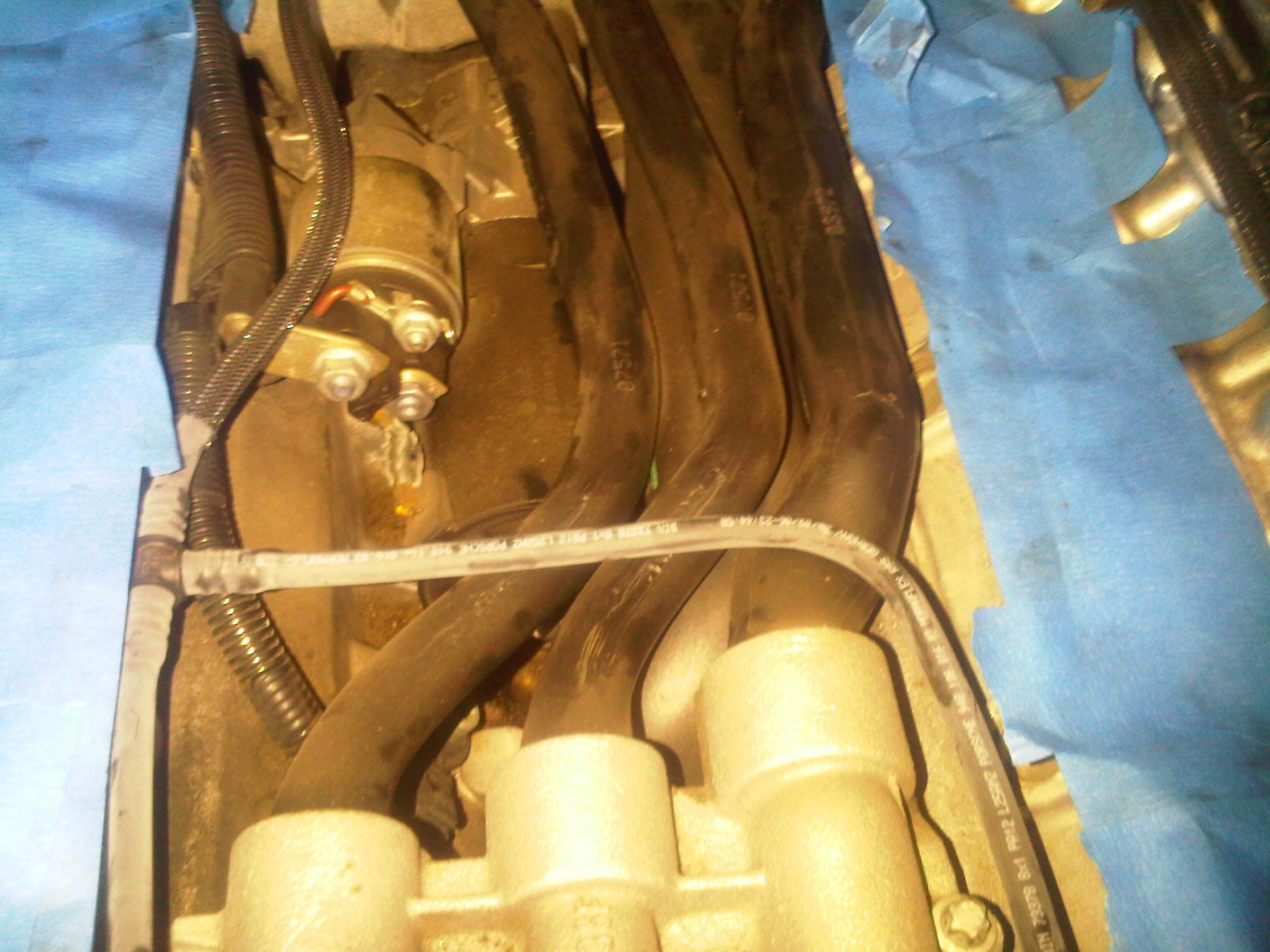

So I had the coolant lines changed 35K miles ago by the dealer, before I knew better and got raped in the process -Im over it.. But just Friday it happend again. Coolant flowing heavy from rear of the motor, drains within seconds.
I removed the intake today.. Same plastic pipes but no visual signs of cracks or excessive moisture. There is a very small (very small) amount of moisture under the starter.
Is it possible those pipes cracked again so soon?
More importantly (and fearfully) Could it be something else like the rubber pipes that connect to the plastic ones and run behind the motor? :unsure: How can I tell?

post-58823-070168200 1278465881_thumb.jp
post-58823-065829100 1278465902_thumb.jp
post-58823-088713500 1278465926_thumb.jp
If you don't see any coolant under the intake you may want to check the plastic y pipe that comes off the back of the pipe which is the far right of the three on top. Its unique to the Turbo and it has shown to be another weak link in the cayenne coolant system.

Plastic pipes were reinstalled cause I got shafted. Paid A LOT of money too.. They sold me on the "oh we have to remove the front end of your car, take out the motor, take things apart to discover what the problem is." As if the pipes and coolant system didn't have well known issues. ...Unless they changed the pipes that go down the back of the motor, those are aluminum, but I doubt it. I can't find the invoice to check, Ill keep looking.
Anyway, Yes, it is the plastic Y piece that is just behind the 3 pipes connected to the one closest to the driver side. Huge crack.

Well, depending on when you had yours repaired, the aluminum pipes might not have been available yet. IIRC, the plastic pipes were longer available from Porsche parts as soon as the aluminum pipes were released. If this is the case, the engine did indeed have to be removed to replace the plastic pipes with new(old) plastic pipes.
Anyhow the Y piece that you're describing is still plastic unfortuately.
The T pipes, to my knowledge were never replaced with metal ones. I know someone who tried to fabricate metal ones and failed. Life expectancy of the T pipes varies depending on geographic location, similar to the coolant pipe, expect every 50K worst case until they decide to put metal in.
