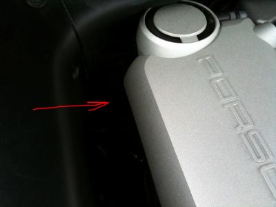

Here is more information:
If you look at the picture, you will see where is located the upper timing chain tensioner. The last picture is the defect part with the new box and you can see the part number (vw dealer number, same as touareg 3.2L). Check this picture and you will see the week free play of the tensioner (the chrome color). The brand new part is able to move like the green line, and the defect only the red line distance.
This resolve about 95% of the problem, but I drove about 100,000 km with the defect tensioner and I probably damaged the timing chain or the lower tensioner.
If you go to youtube, you can hear the noise (about a minute after startup) before I changed the part:
Thanks I hope this will help you.
Just let me know if it works on your engine.

I will let you know as soon as possible. Volkswagen didnt have the part in stock, but they will get i tomorrow, so I will try to replace it then ;)
Mine doesnt make as much noise as youres but still there is something wrong, so lets just hope this works !
