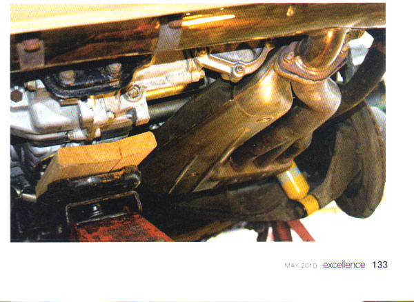

By the way, I got a chuckle from this photo in this months Excellence magazine.

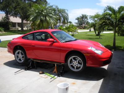

Since I wrote the original post, I had installed the ROW M030 suspension on my car, and it lowered it to about the height of a turbo, so now what I do to get the Jack under the rear of the car is drive the rear tires onto some short 2x4s. That 1.5" of additional clearance is all I need to get the jack under the rear.
Similar to Orient, after installing PSS10's, I built some little helper ramps for the rear wheels to drive up on out of 2x10x8 board cut in half and doubled over (to give an extra 3 inches of lift).
Then I can fit my floor jack completely under the rear of the car.

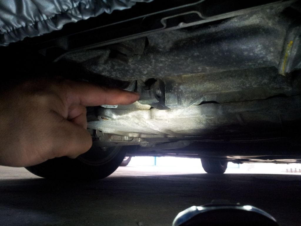

Sorry to resurrect this thread. Your engine looks really clean - wow! Mine is really untidy looking so I'm having difficulty in determining if it's the right spot or not.
Is this the same and right spot???

OK, perhaps this picture could help to pinpoint the place where to jack the car. Could someone circle the location? I'm confused as to where exactly place the jack.
The engine should not be used as a jacking point if the car is equipped with hydraulic engine mounts which is the case for non mod. 996/7 C2/4. The risk of damage to the hydraulic mounts is present, they have been designed to carry hanging weight (engine). If you use the engine as a jacking point, the mounts are pressed, where they are not designed for, with a much higher weight namely the entire rear end of the car.

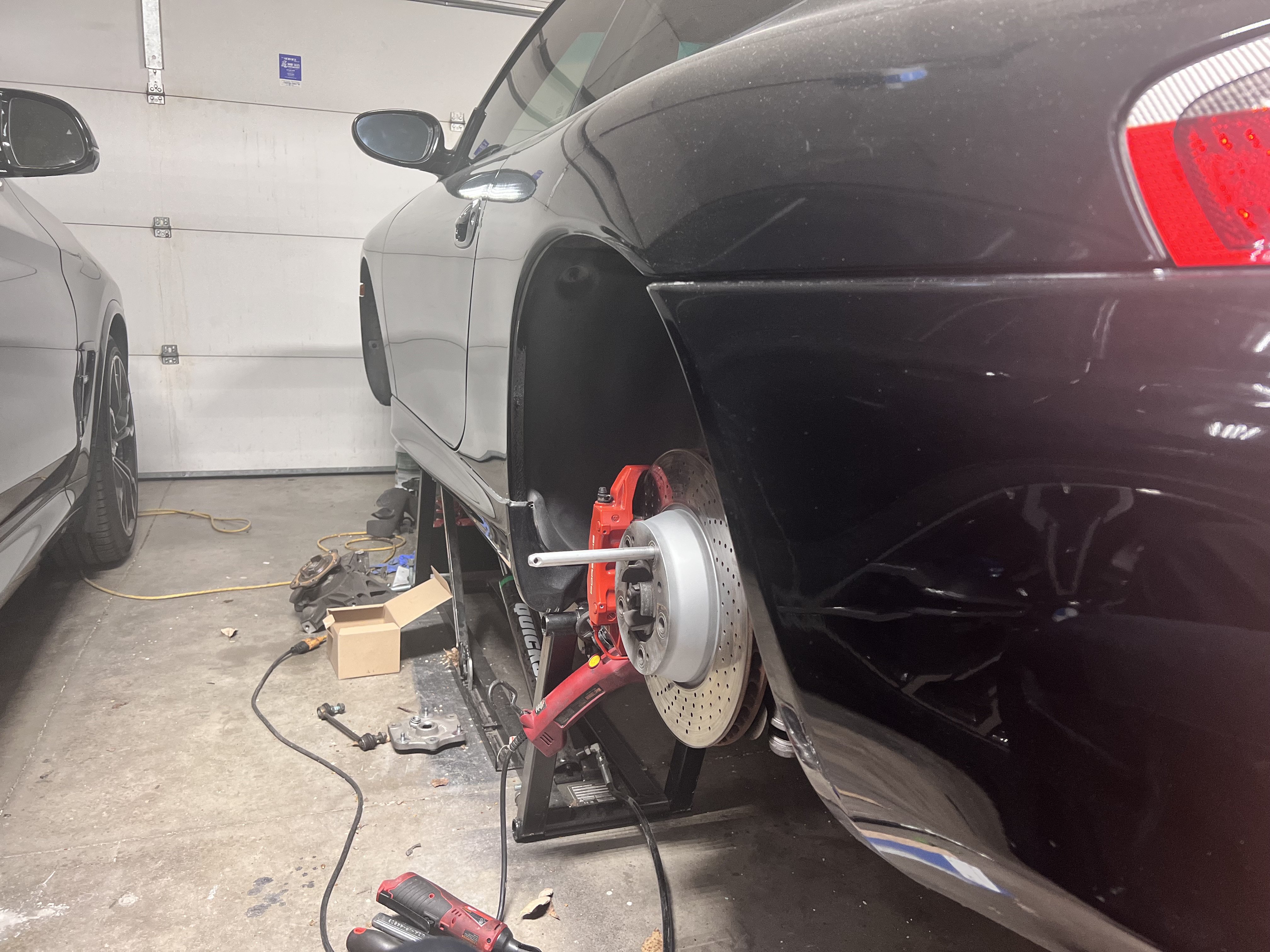

1. I bought 4 ESCO jack stands from Amazon for $220.  Seeing the jack points on the 996 worries me that I would need all kinds of chunks of wood to work with the saddle type and round steel type stands I already have.  Annoying and not the safest way.   I bought the regular ESCO stands.  In hindsight, the low-profile ones are probably better for our cars, but at least I'll be ready any real big job that comes up.  The ESCO stands work PERFECTLY with the 996 jack points.  I wished I'd bought these a decade ago for all my cars.
2. I bought a 2x10 and cut four 18" long pieces.
3. Using my trusty aluminum "racing" jack from Harbor Freight, I jacked up the car using the right rear jack point.
4. With jack on lowest point, slide it under the right front jack point.
5. Slide two 2x10 pieces double-stacked under the right rear tire.
6. Lower the car onto the stand and wood.
7. Repeat on the left side.  (side order doesn't matter)
8. With the rear tires 3" off the ground, it's easy to reach the best rear jacking point - the center of the suspension cross member.
9. Lift car enough to get jack stands under both rear jack points.
10. Lower car onto jack stands.  Ta-da!  That's pretty fast and easy!
11. Slide wood boards out of the way.  Remove wheels.
For my suspension project (Ohlins coil-overs), I think I'll have enough room.  But if you need to raise the car higher, it's easy now that the wheels are removed.  So I suggest always starting with the jack stands in the lowest positions.  For the rear, use the center of the suspension cross member (duh!).  For the front, you can now get to the reinforced part of the body just inside the front jack point.  (This is impossible when the car is on the ground, which makes the Pelican article most useless IMO.)  see yellow arrow in figure 1 at link below.
