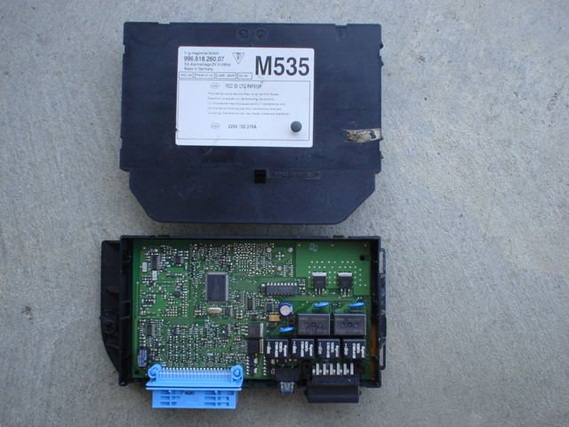

I have that ebay control unit. It is for a 1998-2000 Boxster or 1998-2000 996, with the 535 option. Might be willing to trade it for something.
Showed it to the mechanics at the local dealer and learned something. Hope I understood what I was told.
There is an immobilizer code already burned in the used unit which cannot be changed. That code matches the code in the DME of the donor car. If you put the used unit in your car your car will not start because the code from the used unit does not match the code in your DME.
Although you cannot change the code in a used control unit, you can change the code in a DME with the PST2/PIWIS. With the VIN from the donor car Atlanta will provide the immobilizer code for the used control unit. You then change the code in your DME to match the code in the used unit. I have the VIN for the donor car.
We opened the unit up and it looked ok. This unit sits under the driver's seat in a recessed area. The common problem is that if water get in this area it enters the control unit and fries the electronics.

i didn't think that i had an alarm on my car; the option number is not on the hood sticker and my key is just the standard (no buttons) key.
i took out my driver's seat this weekend while installing stereo equipment. under the seat is a component that looks like the one in the photos on this thread. the number on it is M531 though. the part number is 986.618.260.03. Anyone know what this is? thanks.

Anti-drive-off featue and central locking.
