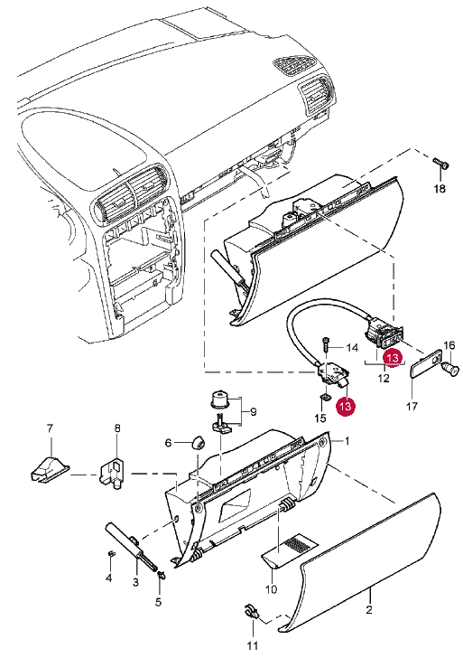

Looking for the part number for the glove box push button assembly. The piece that pulls the cable broke. Can post a picture if needed.

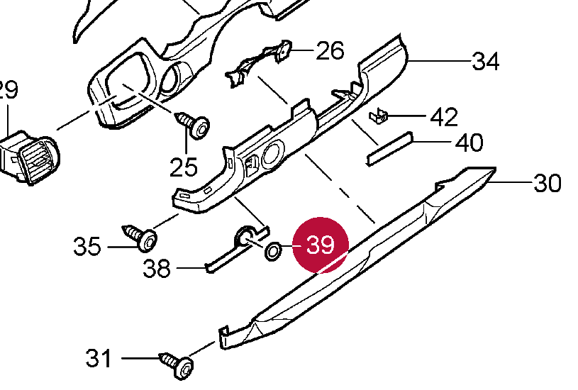

oops, one other thing. The trim piece around the key.

955.552.127.01 Housing glove box lock (item 12) -- US MSRP $13.11
955.552.128.00 Catch glove box (item 13) -- US MSRP $13.11

Rosette (item 39 or dash trim 38)?
Part number 39 is correct. The little round piece. It was missing when I purchased it so I really don't know what to expect.
