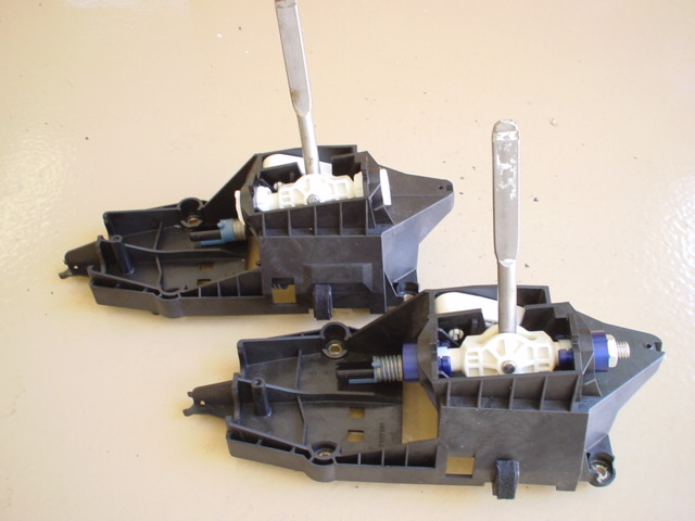

Has anyone done this? I had to break the tabs on the old shifter to get it out. I'm assuming that I'll need to replace them if I want to put it back in my car. Are they available as separate parts or do you have to buy a whole new shifter.

Porsche does not sell just the bushings.
What you can do is use the B&M bushings with the oem shift. That is what you see in the front shift tower.
