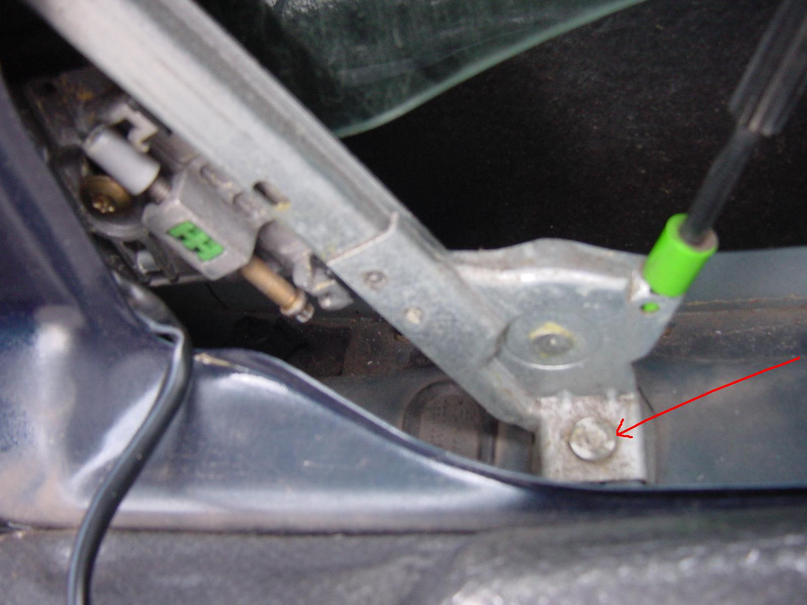

How do I adjust the drivers side window to tilt in just a bit on the rear top side of the drivers door? I get a wind noise when driving at highway speeds just behind my left ear. If I touch that top rear corner of the window it gets louder?
Rob:
1. Look under the lower horizontal part of the door.
2. You will see 4 rubber plugs (2 on each side). Pull out the inner (towards the front) of the two plugs that are on the rear side (closest to the striker plate on the door).
3. Loosen the 10mm (IIRC) nut that is inside that hole.
4. Move the bolt (by placing your 10mm socket over the nut) towards the outboard side of the car and the rear top left edge of the window will move inboard until you get a correct fit with some pressure against the gasket.
5. Tighten the nut.
6. Replace the rubber plug.
Here is a photo of the bolt (stud) that is pressed in to the bottom of the window regulator rear leg, directly above the nut you are looking for. You can see the other (outer) rubber plug just to the left of it. The rubber plug you are looking for is directly under the stud to the front of the rubber plug you can see in this photo:
(click on the photo to blow it up)
I posted some other photos on this some time ago (more than a year), so do a search here for that post. If I run across it first, I'll post the link.
Edited by 1schoir
Excellent instructions, thank you I just did the adjustment it took about 60 seconds from start to finish. Thank you!
