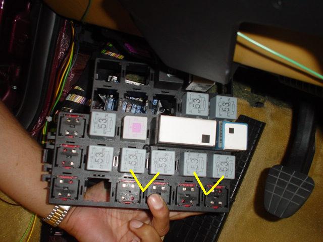

There are 2 relays for each fan, high and low speed. I have them marked in pairs for each side of the car, but the wiring diagram does not say which pair is for what side. All 4 of them are identical so you can start swaping to see if that is the problem.

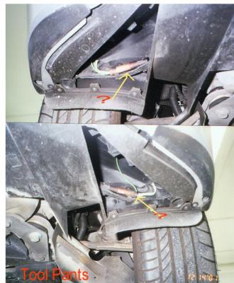

There is also a ballast resistor for each fan. If that goes bad then the one fan on that resistor will not work.

Start your car and listen to it...when the first fan comes on, on the left side, that's the low speed. Then wait awhile and you should hair an increase in speed of the left fan, and if the right side still doesn't come on then, it's probably something else.
Anyways, to access all the wiring for the radiator fan, you have to remove your right front wheel and then take out the plastic panel behind it (real easy to do).
Then up at the front, you'll see the wires for the radiator fan, which consisters of like 3 parts or so and one of those parts is the resistor (you'd have to pull it out since the entire apparatus is wrapped around the front bumper). It is most likely that one of these 3 parts is the problem.

The resistor is a small capsule like tube(maybe 3-4 inches long) that has a few green and black wires running into it (I cant remember exactly). Its pretty easy to find if you look up from underneath at the area behind the radiators.
Problem solved ! it was the resistor. it would allow the high speed side to work but failed on the low speed.
