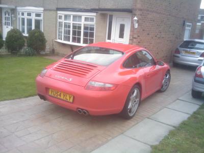

Recently purchase a 54 plate Carrera S.
Have noticed a black build up around the left two exhausts and not around the right two.
Is this common, potentially something I should be worried about?

Here's another post describing the same symptom your car has, where the engine was replaced by Porsche:
http://www.renntech....-engine-issues/
I'm sorry friend, but from the looks of that oil soot you may have engine damage. I'd stop driving the car further and let your mechanic have a look ASAP. Is the car warrantied?
Mark
