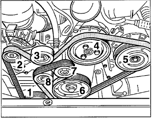

Belt tensioner roller on lever for tensioning element - 44 ftlb.
Belt deflection roller 1 to crankcase M10 x 145 (10.9) - 48 ftlb. and M10 x 145 (8.8) - 34 ftlb.
Belt deflection roller 2 to bracket for hydraulic pump M8 x 55 - 17ftlb.
Belt pulley to generator M16 x 1.5 - 48 +- 3.5 ftlb.
Belt pulley to hydraulic pump M8 x 12 - 17 ftlb.

Forgot to mention. Are these the same for tiptronic. For some reason parts are listed different for manual or tip. I have a tip..... Thanks........
Specifically what I need from the polyrib belt change are torques for Number 3 and number 8 rollers. For a tip car.... thanks loren u rock.....
They are no different for 6 speed or Tip. Nor for AC or no AC.
I gave you the toques above - ig you are not sure which is which check the bolt sizes.
Loren:
Sorry for sounding so stupid...sad.gif . Just this last question. The pulley that has the bolt that holds the alternator in place the one u have to hammer to loose the bearing. That is the one I need. Im thinking this one is 48 ftlbs from what u wrote above. Am I correct? I did the p0410 repair and replaced 2 idler pulleys, the one mentioned on top and the one right after the tension roller that bolts to the crankcase(think this is the one is 34ftlbs) and the belt while I was doing it. Im getting a weird noise at really high rpms like a roller is rubbing or something. Just want to make sure everything is tightened up correctly. They roll fine when the belt is off. If it makes it any easier to answer my question the rollers I replaced are number 8 and number 3 in this picture. From ur reply im thinking 8 is 34ftlb and 3 is 48ftlb?? Just want to make sure im understanding correctly. Thanks a ton and sorry for not understanding so easily....
