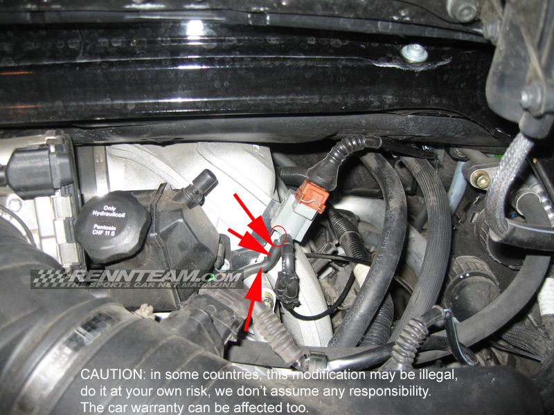

It's easy to bypass the control values. Just pull the electrical connector off the controller. Search the fourm, tons of pics. I like the sound load all the time. I also bypassed the intake resonator at it gets a very Porsche sounding howl at 3 and 6k. Very fun.

Aliballan,
If you want the PSE on all the time (like I do) just disconnect the orange connector shown in the photo. You can disconnect the hose as shown in the photo too for the same effect. Disconnecting the orange connector is much easier. Zip tie it to a nearby cable and cover the electrical ends so debris doesn't get in them. I use the fingers of latex gloves and made little "condoms" for the connector ends.
Super easy to switch back to stock if you want to..

phillipj posted a good pic on how to pull the elec harness entering the vacuum switch for the PSE valves. Personally I just leave my connecter sitting on top of the value, just not seated all the way. It won't make elec contact with snapping down. That way it stays clean and looks normal.

Haven't disconnecting the valves yet. Want to clear something up though, if i do disconnect the electric wire for the valves as explained in the previous replies does this cancel out the on - off option for the sports exhaust???

Aliballan,
Yes it does cancel the on/off function in the Sport Chrono. The PSE is loud all the time. Which I think is the way the car should sound.....
