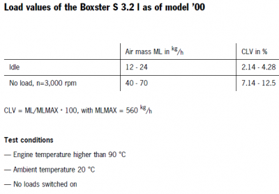

What mass is the meter reading at idle and at 2000 RPM?
Sorry to jump in on this one but I was wondering what is an average airflow reading for a 986 S (2001 model) at idle & 2000RPM. I can't check mine at the moment as I am away from the vehicle & OBDII reader but as I'm new to all this I've been trying to decipher my car's data.
I am out of town till Friday. I will hook up the Durametric and see what the readings are at Idle and 2000 rpm..
At idle, oil temp 97.25c
760 rpm, 1.35 to 1.37 air mass 15 to 15.25
At 2000 rpm
2000 rpm 1.64 and air mass 32.25
Any help appreciated..
