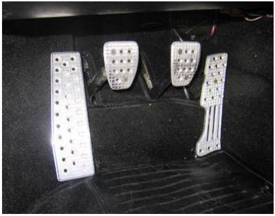

Over the weekend, I purchased a set of alloy pedals from ebay for my 2003 911 C4S, but I screwed up because in my hastiness I ended buying a set that does not exactly fit my model. However, I can still use the set if I do some minor customization. But I need some info and advice before I implement a customized solution. My apologies if I don't know all the terms as I am new to this and this is my first Porsche.
Here is a little background on my situation. My main issue is with the gas pedal. The new gas pedal is a complete replacement of the existing pedal as opposed to a cover that simply attaches to the existing pedal. I am at a point of no return as I have already removed the existing gas pedal and damaged the 4 rings, for lack of a better word, that are located on the hinge at the base of the pedal. Behind the existing pedal is a ball and rod that extends out through a tiny hole of a housing, and the ball connects to the pedal by use of a socket, creating what is essentially a ball joint. The new pedal is intended to be bolted to the floor. I have attached a picture of the pedal set. I can upload more pics later if you guys need it.

Note: the pics attached are from the ebay posting, so the pic showing the pedals as installed are of a pre-996 set up.

Thanks for the feedback guys, but the gas pedal is indeed a replacement of the factory pedal. I have already installed the clutch pedal and the brake pedal. I'm just concerned mainly about the gas pedal right now.
After conducting more research, I realized that there are gas pedals (typically ones used for heel toe shifting) that allow the ball-joint to be attached to several different positions (top to bottom) along the back of the pedal allowing for different pedal heights. Thus, I don't have to be too concerned with the angle which I was referring to. Can anyone confirm this?
